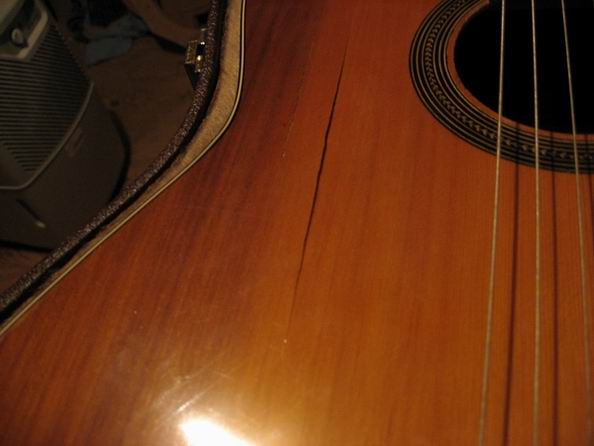

I was asked to look at this guitar and assess the damage.
The owner doesn't mind if the repair is not invisible as long as the crack is secured. I thought this was a good thing since the top is stained and the guitar is almost 30 years old... It's a Canadian made 1979 Kamouraska classical with a solid top, back and sides. It was a fairly expensive guitar at the time of purchase.
I haven't had a chance to take the strings off yet to see how well the crack closes.
I was thinking a veneer backing from the inside. My concern is that if the crack doesn't close 100%, I'm going to have to fill the gap with stained epoxy
Any thoughts?
Thanks in advance.
Alain
PostPosted: Wed Sep 20, 2006 10:32 pm
if the crack doesn't close , rather than glop in a load of epoxy, it would be better to insert a splinter.
PostPosted: Wed Sep 20, 2006 10:45 pm
Humidify the guitar and see what happens, before you do anything else.

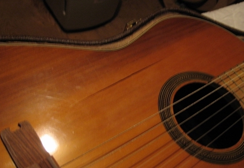

Looks like there may be a second crack closer to the waist.
PostPosted: Wed Sep 20, 2006 11:55 pm
I bet the thing closes. but if not add a splint. Gap filling with epoxy is not a good idea.
PostPosted: Thu Sep 21, 2006 12:32 am
Posts: 728
Definitely splint it, it can be pretty easy to do and can be almost invisibe. Let me know if you need any help,
Evan
PostPosted: Thu Sep 21, 2006 3:07 am
Posts: 170
I agree with Evan, a crack that large needs a splint.
Tom

PostPosted: Thu Sep 21, 2006 3:57 am
Posts: 1059
Is the large appearance of the crack due to separation -- causing a gap -- or is it caused by one side of the wood sort of sitting on top of the wood on the other side of the crack? If the latter, you might be able to close the crack without having a gap. Sometimes, though, with cracks like that, the edges can get "hung up" against themselves, and won't close easily. You might try inserting a thin spatula between the edges and see if you can carefully pry the gap closed, kinda like you would pry a bicycle tire off its rim. If it closes up, then hide glue and cleats should work fine, I would think.
Also, since this is a classical, and assuming that it has the two transverse braces (aka "tonebars") above and below the soundhole, the wood will have had to separate from at least one of the tonebars to do this, probably just the one below the soundhole. You'll need to check this as well, but I'd check both tone bars.

PostPosted: Thu Sep 21, 2006 5:19 am
I am no expert at this Alain, but I think little pyramid shaped blocks (small and LIGHT ones) would be better than a veneer, which would, when coupled with glue, tend to dampen the activity of the top, think plywood.
So use little blocks as Michael has suggested with hide glue. Just press them on by hand and hold for about 60 seconds or so and they will bond quite well and will actually pull themselves tighter as the glue dries.
Good luck!
PostPosted: Thu Sep 21, 2006 8:24 am
I bet you can close it by adding moisture.

Thanks for your help guys.
Indeed, epoxy is a bad idea.
It turns out that the upper transverse bar was unglued. I glued it back using good old titebond. I know I got a good amount in there, I had squeeze out from the cracks on the top.
Once glued in, the crack closed nice and tight. No sliver needed. I added little blocks from inside. These I glued using my very favorite glue in the whole wide world... HHG!!!
Now I've got the slightest hint of crack when you look across it with low angle light. What would be the best thing to do? Drop fill with CA, scrape, sand and stain?
The owner said I could go nuts as long as it wasn't with the bill...    I would really like that crack to disappear completely. Any thoughts?
Thanks again guys.

PostPosted: Thu Sep 21, 2006 3:26 pm
No dust, no epoxy! I agree with others here, humidify the guitar and if it does not close all the way cut a splint and insert. Once this is done, I would glue a few supports over the crack from the inside.
I did a 1960's classical you all may recall a month or so ago, I posted to get some opinions or other methods. It was really not that hard to match the splint color, it just took some time and patience.

PostPosted: Fri Sep 22, 2006 2:46 am
Al, I guess the question is directed to me. I put a water sponge pack inside the guitar and inside the case and let it set for two weeks. The crack was still visible since it ran from the bridge to the tail down the plate joining line. The Soundboard had a natural coloration change down the join line and some of the appearance was in fact the separation of the finish itself. The crack went from larger than what we see on these photos to about a razor blade gap or less after rehydration but still to visible in my view. I went through the scrap stash, and found as close a grain match and color as possible, cut a thin tiangular shaped splint using a razor knife. I worked back and forth trimming ever so gently. I got the splint to a nice tight fit and then began working on the coloration issue using a couple of other splints I cut using a variety of products. Once I determined what worked then I applied it to the real splint, let it dry, and compared again. It took some time but I got a good match. I then applied a little Titebond to the splint and set it in the gap. Careful application to avoid glue smear. After drying I used a flat razor blade and trimed the top ot the splint to the existing surface. With a fine tip paint brush and MagnaLight to see, I dabbed a little more coloration mixture in the trim areas. After this was completed then I cleated the underside running along the repaired line using small spruce squares I also cut with some scrap.
Hope this answers the question and helps you Alain, the process was rather time consuming but the results were worth the effort.

PostPosted: Fri Sep 22, 2006 4:38 pm
Alain,
I have several different shellac flakes, many with color. The coloration on this guitar was a vintage dark golden color, I mixed me up a batch of vintage dark golden color as best I could and then played with it from there. I have never used any of the dyes but that may work as well. Good luck with the repair and post some pics as you go or once finished.
